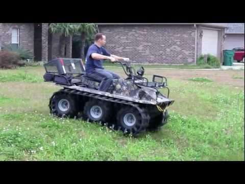

    Well I sold both of my Kid 8x8s. Hope the new owners have lots of fun with them from Louisiana 1 went to Wisconsin and the other to New Jersey!!
    I invested some of the money into a set of Adair tracks for my Hoot. Utube attached of the first run. Tim and crew at Adair Argo did another fine job!
    I had to use 3 inch spacers to clear the fenders and now I get lots of water and mud flung inside so I'm waiting for some belt material to extend the fenders before more water testing. I also trimmed the fenders alittle due to the tracks hitting when flexing.
    Now it goes the best ever in mud, but with me being a "big load" and the track weight it feels like it could use some more HP than the 15 Kohler. But I had to tow my sons Honda 4x4 and him about a mile and a half and it did fine, even up some small hills.

            Thanks, I think my Hoot is just getting about right (with the Adair tracks)! I have over 140 hrs on it and here's the good and the bad.
            GOOD - (Great) Goes just about anywhere, I have rescued some of those really big atvs from flooded timber and ponds that were just a little too deep. I may not be able to pull them but I can get to them to jump or pull a line back to hard ground and then pull. It turns on a dime so I VERY seldom have to use reverse to back up and make turns or get around things, it hauls a good amount of STUFF, bottom line it gets me where I need to go with everything I need to have. Also it's pretty straight forward to work on. I can get into tighter areas than Argos, etc but I can't haul as much.
            BAD - The Hoot tops out Way slower than some of the atvs, but hey I still get there, the lack of suspension compared to atvs, you know what I mean! I Wish it had a little more HP for my big lard-ass. and, it can't ride 2 in the water! I tried with my 100# lab and we just about sunk, had to make him swim for it! Thank you bilge pump! In fact I might add a 2nd, the rear tends to ride low in the water. It would be nice to have a "Water dam" built up on the rear deck. Hey my next project idea! (Rides 2 fine on land)
            Overall - I think it's More fun and gets WAY more looks than any regular atv! Oh yes, if you get one, definitely put in a bilge pump or 2! because you will push the envelope!
            Other additions - I added 2 huge computer fans to the dash side of the engine as "pullers" they use less power that the front main fan and I think move as much air and use them most of the time. All are on switches to not drain the battery and when it's really August hot, ok I use all of them, the front pulls air in and the rears pull it out. I'm not really sure if I have ever had an engine overheating issue, maybe some type of temp gauge would be good to track it.
