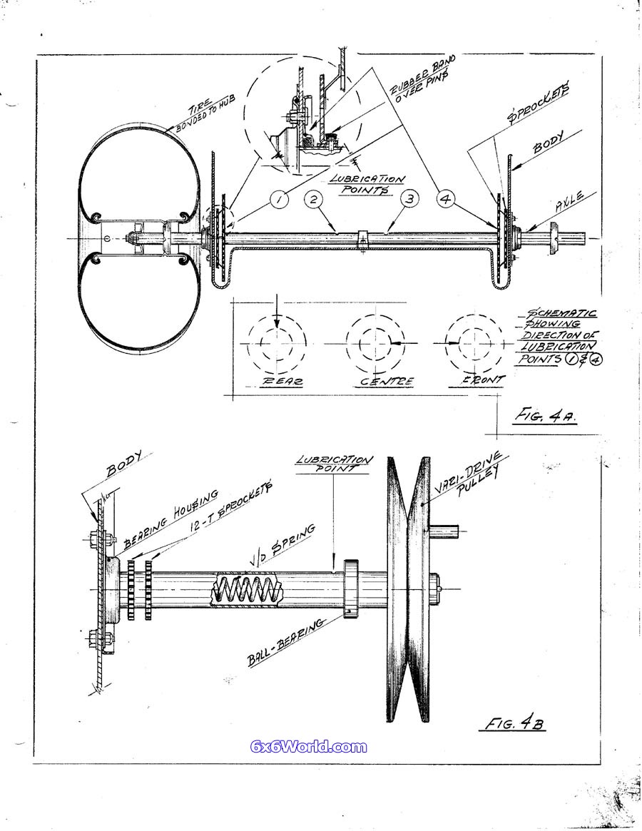

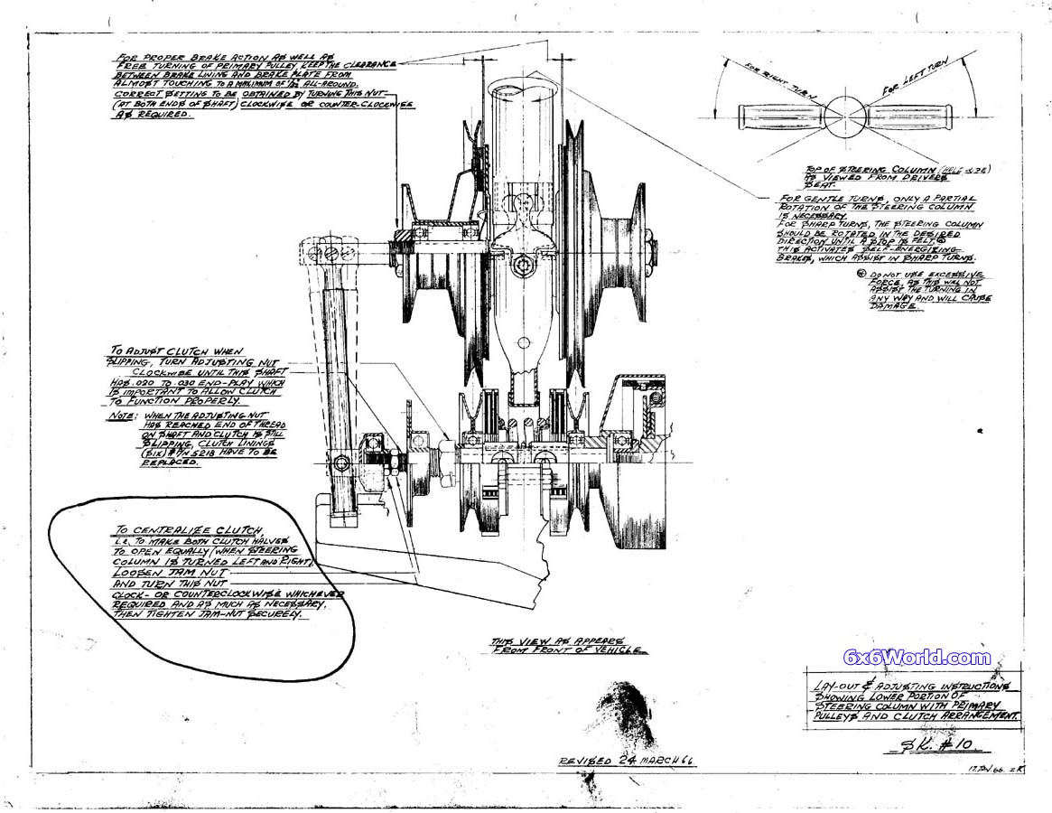

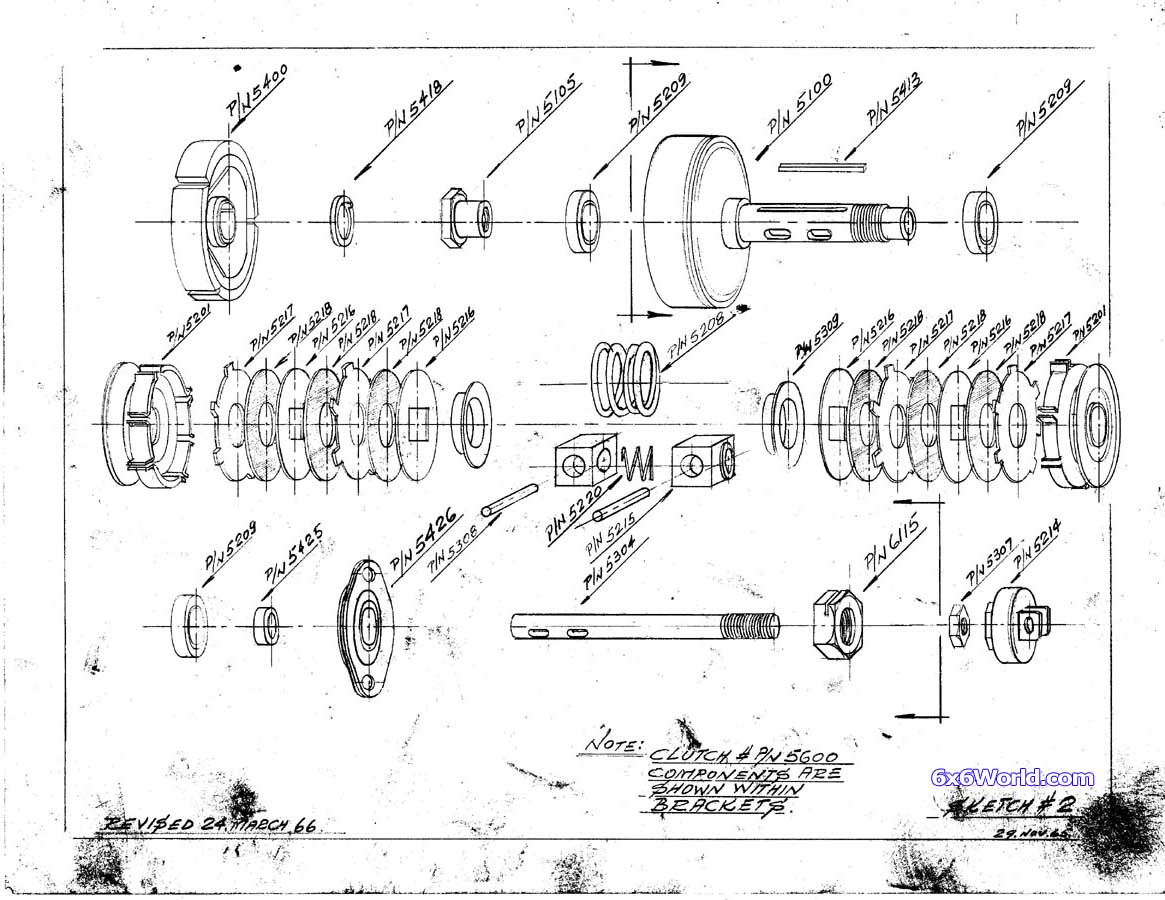

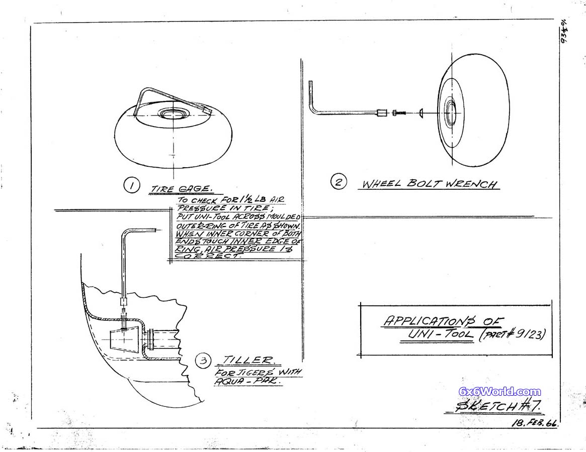

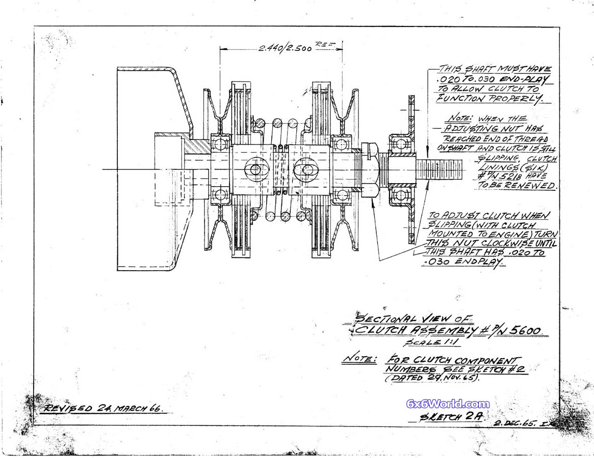

Here is a Jiger owners manual for dealers only including operating instructions and a parts list for the Jiger amphibious ATV that was manufactured in Ontario, Canada starting in the 1960s.
